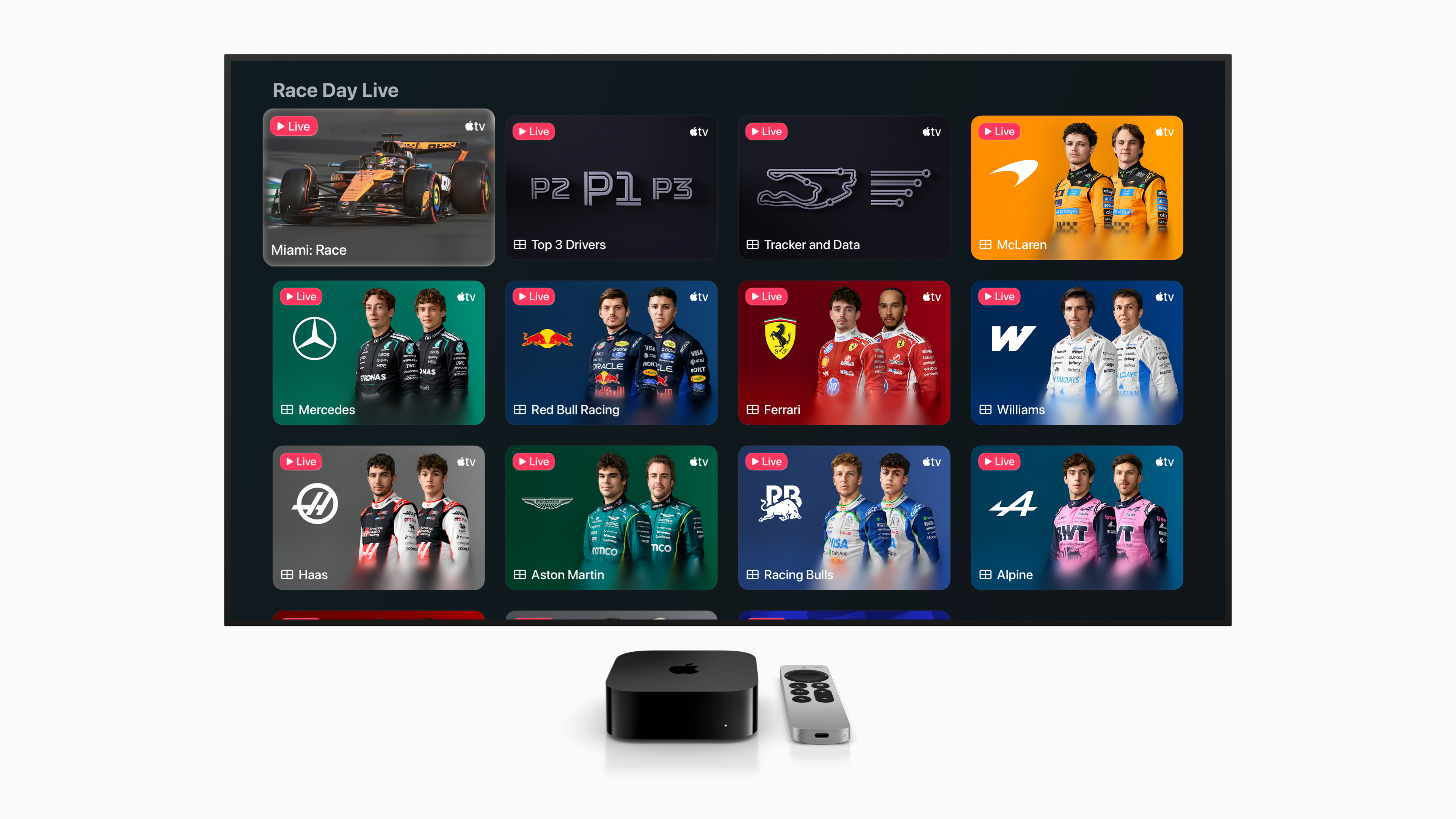

Here’s what F1’s multi view looks like in Apple’s TV app. Apple

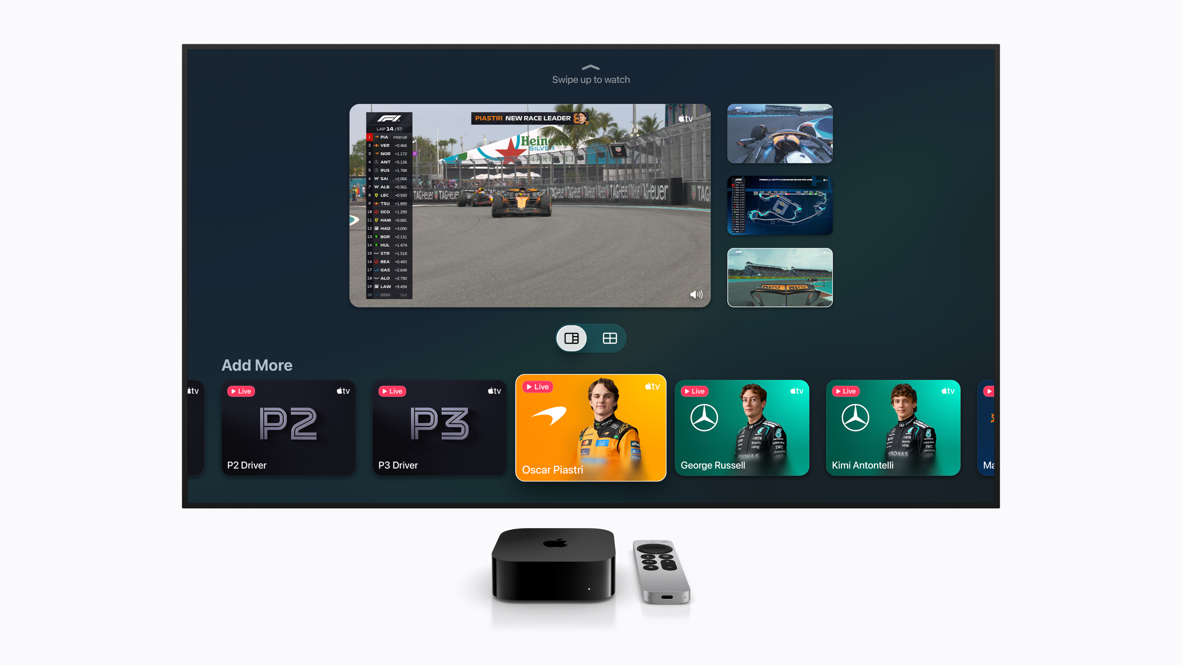

Driver feeds in the Apple TV F1 multi view page. Apple

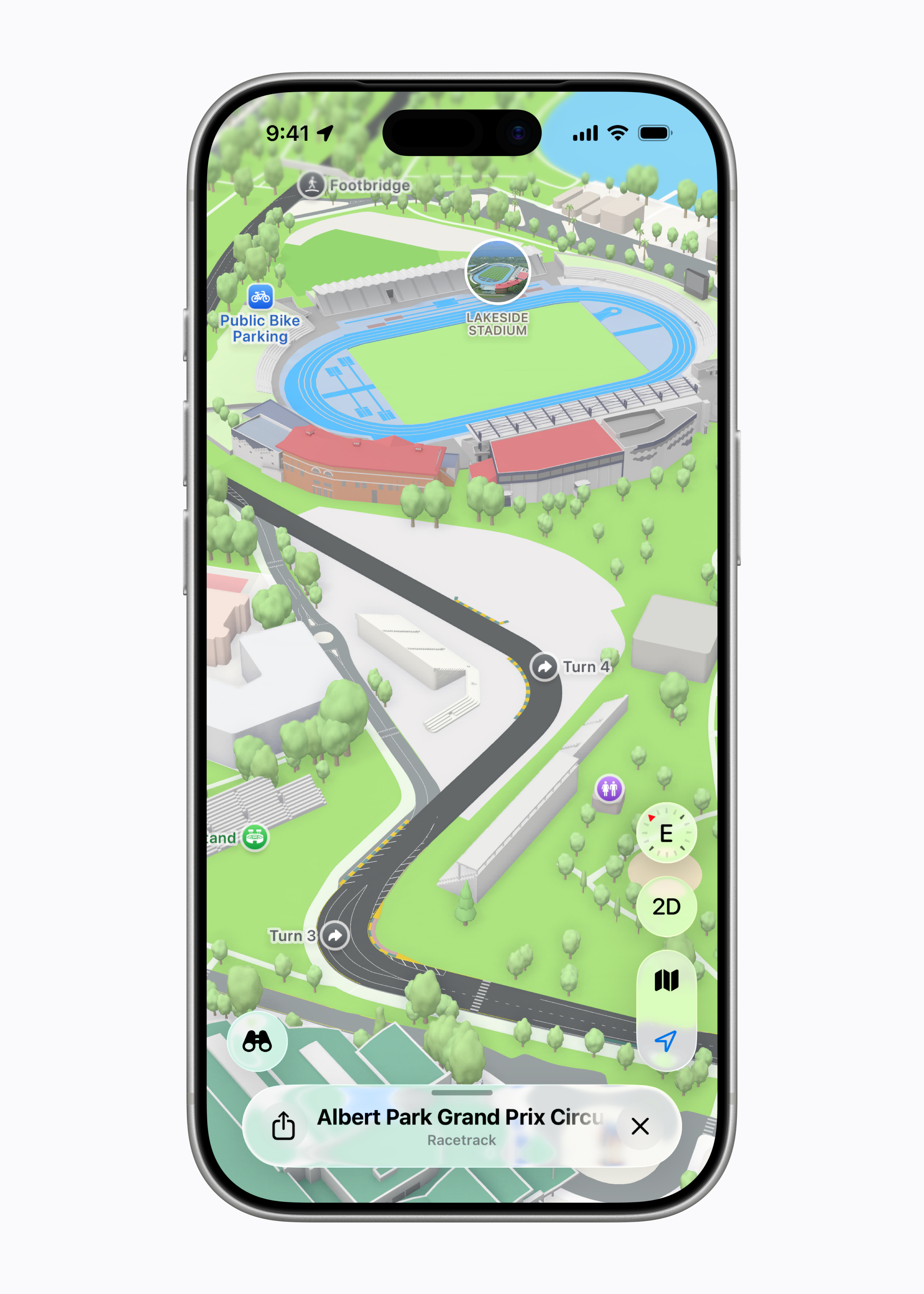

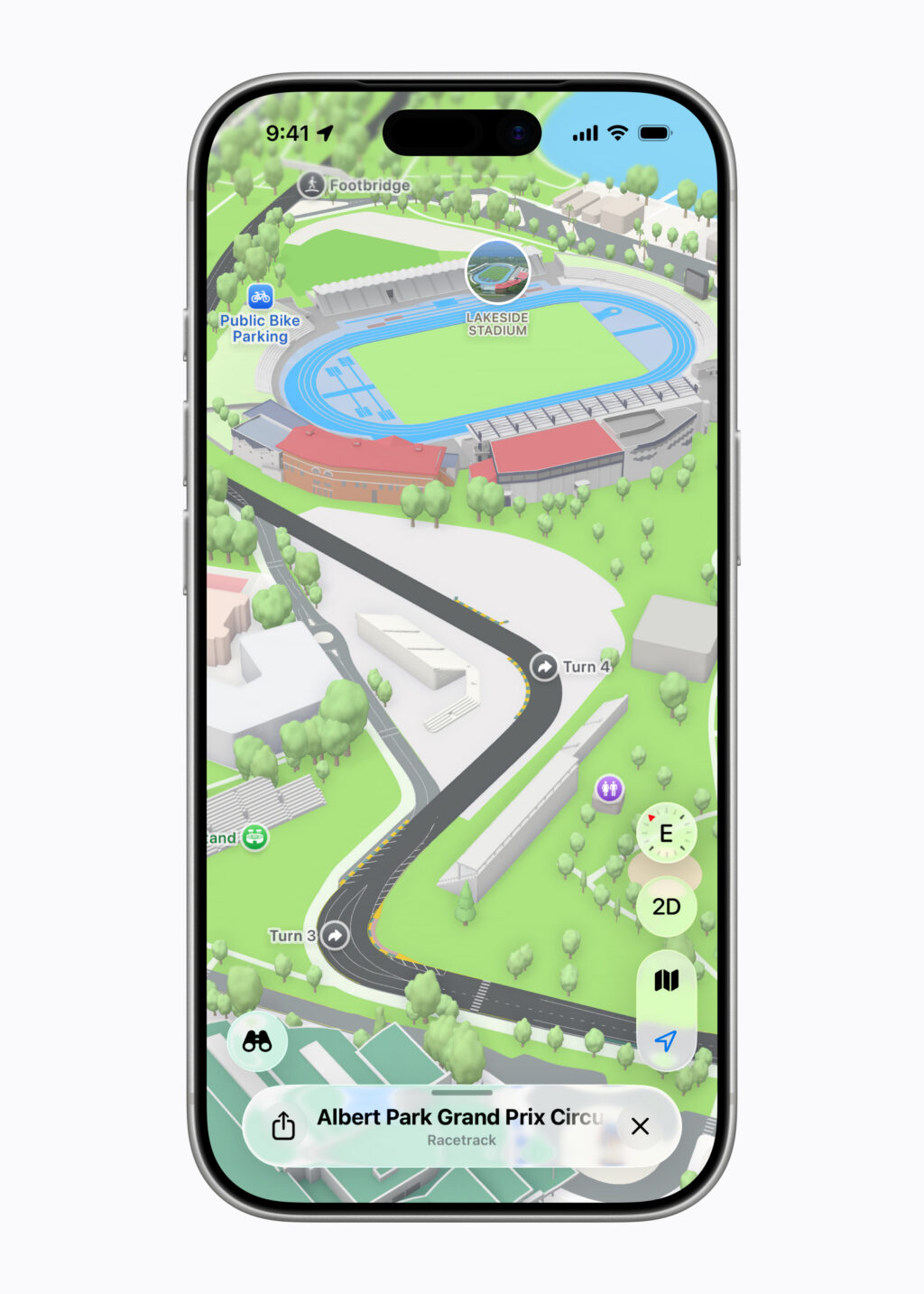

Some circuits are enhanced in Apple Maps. Apple
